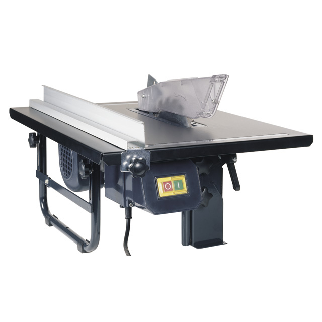

On saturday I bought one of these little toy 1/2 Hp table saws. It only cost $AU68 which is about $US50 and has a two year replacement warranty. I really wished I'd bought some dark glasses with me when I picked it up tho , nobody at the hardware store takes you very seriously if you buy this kind of thing (That's not a tablesaw!, THIS one over here, is a table saw!)
I put one of Shane's fret slotting blades in it and it works great for the cheap little tool that it is. I'm in the process of making a cross cut sled for it that I can set up like Sylvan's jig, and I'll use it as a dedicated fret slotting station, not bad for less than $US100 including Shane's blade.
I'm sort of hovering in between hanging my head in shame for buying a cheap little toy of a tool, and being buzzed 'cause it does exactly what I want it too, and does it very well, even though it took about three hours of tinkering to get it to do it.

Bruce, the sled has long runners that index against the sides of the table, I was a bit worried about how accurate this was going to be, but everything is lined up now that I've shimmed the motor a little, and test cuts have been perfect. That's where the three hours of tinkering went - making everything square and straight. Don't worry, I've thought this thing through pretty thouroughly.
I was going to set this up on a "proper" table saw, but I seem to spend more time setting things like this up, and not so much time building guitars. I figure if I can have dedicated stations set up for each stage of building it's got to be a real time saver.
I don't have stiffeners yet. There were some 3" stiffeners that came with the saw, they help, but 5" stiffeners would be better.
I'll post some more pics once I've got it set up and cutting slots.

This isn't really a 'take it out of the box and start slotting' kinda deal, there's plenty of work and thinkin involved. I've had to make a bunch of mods, and I haven't ruled out making another tabletop with mitre slots just yet. I've got a boxfull of leftover bits and pieces, and I'm sure the saw's warranty is pretty much toast.
I guess the bottom line is that this saw is a bit of a joke, I can't imagine using it "as sold" to do any serious woodworking. But as far as fret slots, it has enough power, I have the right blade, it just needs some serious mods to get it to an acceptable level of accuracy, and that is something that's totally achievable, just a matter of thinking outside the box.
As for arbor sizes, I was going to buy the next saw model up in the price range, but the arbor on that one was 30mm (way too big for Shane's blades). You can use an arbor that's smaller than the hole in your blade by putting in an appropriate sized bush, but unless you want to bore out the hole in your blade you can't use a saw with a bigger arbor. I shopped around for a cheap saw that had the right sized arbor, that was the main limiting factor in my purchase.

I expected someone to bring this up, but no one has. End Play in the motor. IF there is significant travel in the arbor or shaft, you will likely not have a good slot?
Just as we need stabilizers to run these thin blades for slotting, we need tight tolerance on end play. (the right/left movement in the shaft)
The proof is in the puddin' though. Set it up and try it. It could be that a .005" end play, might be just right, due to the tendency of a saw blade to cut to one side or the other. Say it's cutting left .005", most likely all slots will be cut .005" left of the marks.
But if the variance means it cuts a wiggly line with .005" is that acceptable? Just an unknown until the various setups are tried and evaluated.

The saw that I bought is a little bigger than the US saws that have been posted here. The standard blade that comes with mine is 203mm diameter (8"), and the table is 16" wide by 20" deep.
I was very careful to check if there was any movement in the motors shaft, I would have sent it back if there was. It all seems nice and tight, everything runs square and true. Hopefully it will stay that way.
